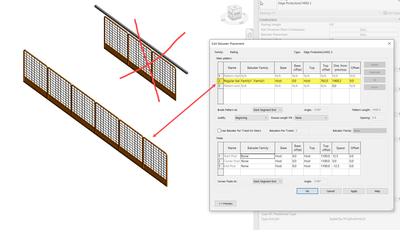

handrail problem
amin_sarvari
I created a railing using only the Handrail1 tool. My only issue is that I have to define a profile for the Handrail type, which creates an unwanted additional handrail above my railing. Does anyone know how to remove this extra handrail?

Message 4 of 10
This is where it is coming from:
None P:
Message 5 of 10
amin_sarvari
Yes,  I want to know if it is possible to get rid of this
Message 6 of 10
It will remove everything.

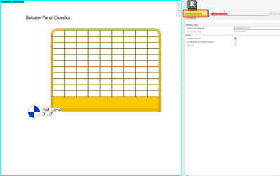

You are building your railing wrong.  You need to make that panel a Baluster Panel and use it this way:
The example I'm showing you above was just a quickly and roughly made to illustrate to you how to build the Railing. It can be made to look exactly like your original, but without that line or using any Supports.

Recreate your panel in the Baluster-Panel.rft (Template).
