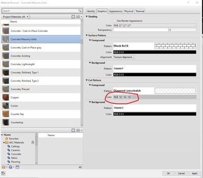

Is there a way to halftone patterns in for model elements, but not halftone the lines.
For instance a cross section showing soil, I want to see the outline of the soil thick, but see the pattern of the soil on halftone.
The only way I could figure it out was to use raster printing, but they makes curved lines choppy.

Could use a surface or cut pattern color override set to its half-toned color in Visibility Graphics...

You can set the color of the cut pattern in the material applied to the topography. And after that you can do additional overrides to it in Visibility Graphic settings. I don't think you can do a 'screening %' type to a color such as in Autocad in this scenario (best realize Revit is not Autocad sooner then later...)
Topography material colorTopography material color
VG overrides for topographyVG overrides for topography

Not sure anymore, is it a lineweight question or a halftone color thing? I think using a color override is the only option for 'halftoning' the cut pattern for this situation... but have a look at the suggestion by @barthbradley to reduce the lineweight anyway, if it's set too thick you want to do something about that for sure...

Lineweight for pen style 1 is set to .001 inch (the lowest it can go) See attached. So, if I am using black line printing, the only way to show hatch patterns is to halftone the 3d element.
What I probably will do is get rid of hatch patterns on 3d elements and use 2d filled regions so I can keep the outlines dark, unless someone has a better idea.
