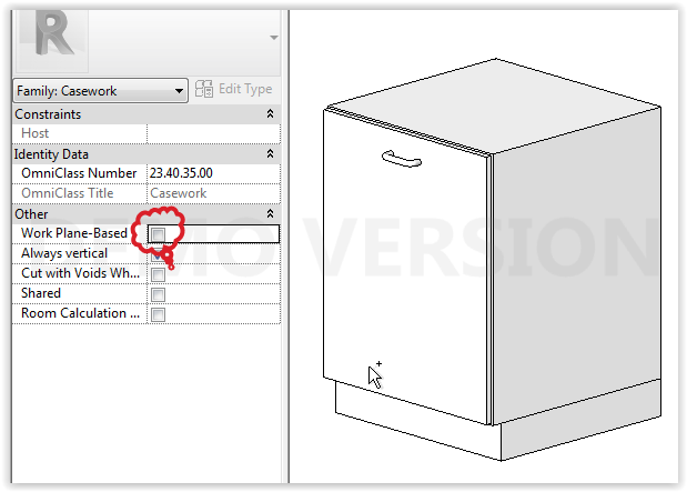

Hi, this is exactly what I found and out after short research.
Groups are not crazy anymore.
Thanks for your support.
LT

Message 15 of 21
@GA-LT: I'm confused. The base cabinets look fine in your original screenshot; it was the wall based cabinets that displaced. How did checking or unchecking the Work Plane-Based parameter in the the Base Cabinet's help? Also, still curious if you got a "Fix Group" error.  It looks like Revit created another group from the original group.
Message 16 of 21
GA-LT
they are not wall or face based. Sometimes I need cabinets when there is nothing around so they are more flexible to be not hosted.
Copied group is exactly the same group as original (there is even no massage about error) but looks different which is very strange but true.
To uncheck Work Plane-Based parameter you have to open cabinet in family editor.
LT
Message 17 of 21
@GA-LT: I understand what the Work Plane-Based Parameter does and how to use.  I also understand, from your above post, that none of the families in your Group are either a Wall or Face Based Family - and that they all have their Work Plane-Based setting unchecked. That means that all the Casework in your Parent Group is hosted to a Level (not Wall, Face or Workplane).
I think I know what's going now and why you’re not getting a “Fix Group” error. Is the “displaced” group, shown in your screenshot, overlapping a Level?
Message 18 of 21
They were broken when the Work Plane box was checked.  They have been fixed after the box was clear.
Message 19 of 21
