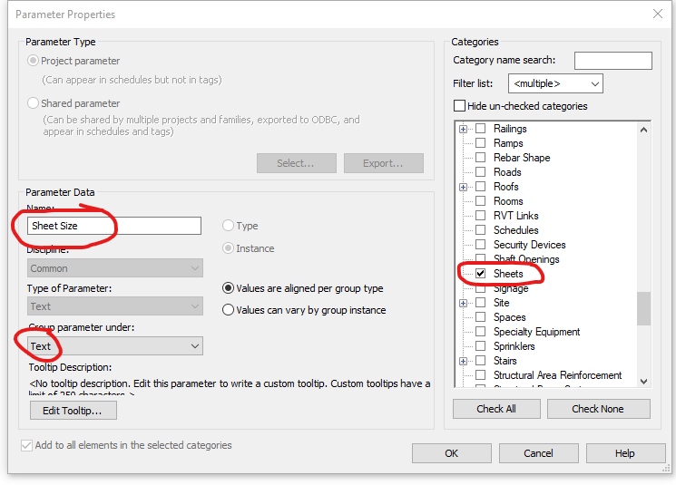

Add a Project text parameter and assign to Sheets category.  Enter value of that parameters or sheets.  Create a new Sheet organization and group by that parameter.
