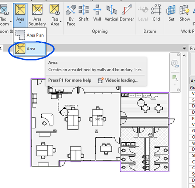

Hi, I'm trying to create a gross building area plan and nothing is working. No area was calculated when I tried to do it automatically, so then I tried to do it manually but again nothing happened so I couldn't manually select the external walls either. I've checked visibility graphics, constraints, still nothing. Tried another thing and the entire floor plan disappeared. Tried YET AGAIN and now, for whatever reason, I can no longer select level 1 as an option. I'm extremely frustrated. Everything thing Revit feels unnecessarily complicated.

Uncheck the box at the bottom of your screenshot.
chiomaun94
I unchecked the box and that helped with getting my levels back but there's still no area being calculated.
Place Area inside the area boundary.
chiomaun94
I'm still not seeing anything happen...
I've attached a copy of my file
Start fresh to learn:
- Delete all these
- Create New Gross Building Area Plan for Level 1
- If you delete the Area, you can add it again:
