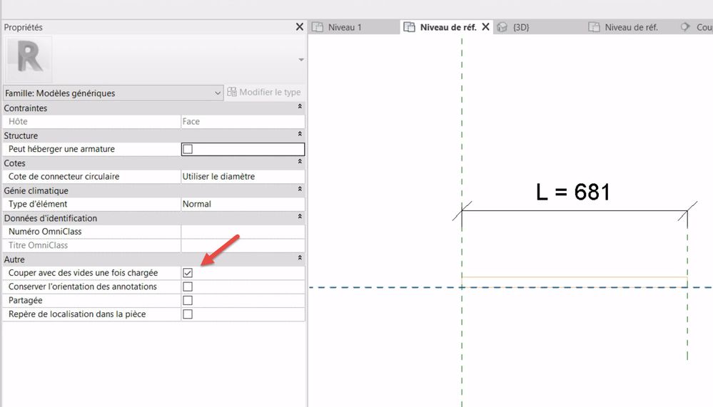

Yien_Chao
als Antwort auf: NERDASORUS
in that case, a simple generic face based extrusion will do. the extrusion must be a void. Then you substract the floor from the family.
