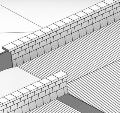

Hi fellas!
I'm working with Revit 2021 in a project, whenever I link one of the other consultants file the 3D-graphics turns transparent/see through. Seems like a graphical bug of some sort, what could be the error behind this? Any solution?
With the link loaded:
Without the link loaded:

Set the link display to custom and turn off Import categories from the link.
Seems to work, guess the file has a faulty DWG? Thanks!
