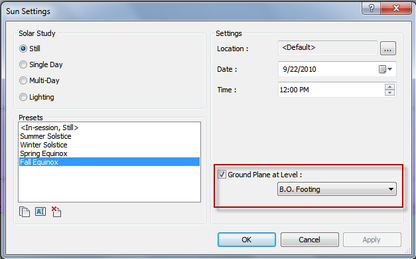

When creating my sections and elevations, I noticed that when adding a gradient background, Revit was using level -1 as my ground level when it is actually level 0. Is there any way that I can fix this?

That is controlled by the Sun Settings in the view.  If you want to change where the horizon is you will need to change it in there.

Thank you very much! it worked just fine.
