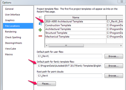

You can start of your project with an imperial or metric template.
In an existing project you can change the units also (on the Manage tab).
Something similar is available in each family.
You can install multiple country libraries. There are some in metric and some in imperial.
Under options you can set default locations for templates libraries (top ones in the list are the defaults)
