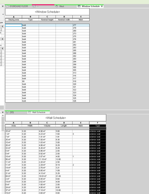

Hello
I want to find an efficient method of calculating a lot of glazing ratios of walls for many buildings. I tried tagging all walls and windows and then creating schedules with areas and marks. I am not sure how to process this data further, can you help me with a piece of advice?

A way around it would be to export wall schedule as its - Version1 . Then delete all doors and windows and export Version2. In Excel I can do calculations. But can you think of all Revit workflow?

Create walls in phase 1 and glazing in phase 2 so you can have a wall schedule without an da wall schedule with glazing on a sheet to compare.
If you want to get them in one schedule then you would need Dynamo to collect the glazing area of each wall and write it to a wall's parameter.
