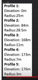

I tried to model the gherkin tower using dynamo and adaptive family but it didn't turned out the way i want it to be. the adaptive family became twisted, i tried to check the reference planes and lines and make sure that the points are adaptive. I also tried flexing the family while in the modeling template and it looks fine. I even tried to remodel the family but to no avail. I still can't figure out what is wrong. can you please check it.
Thanks in advance!

Is it not more complicated to use Dynamo for this? It can be done with a form and some curtain panels.

When placing an adaptive family onto a divided surface or divided line, care must be taken to select the placement points in the proper order as correlates to the order of the adaptive points in the family itself.

Did you use the 'lunchbox' package for the curtain panel node?
Lunchbox is created for Revit 2017)
For those who want to try, here is the step by step process for creating the Gherkin tower in Dynamo and adaptive families:
Here is the screenshot for the elevations and radii
Also, try this link HERE to create the same form from masses

That is impressively quick but I reckon that the main factor is the exceptional skill of the demonstrator.  Given the primitive form of the tower, using Dynamo to model it is not really necessary.  It can be done with a simple revolve.

Using Dynamo, for the curtain panel nodes - if we select diamond panels (3pt) or (4pt)  and vary the adaptive family, we get different facade treatments.
The automation process and permutations and combinations are just amazing!
