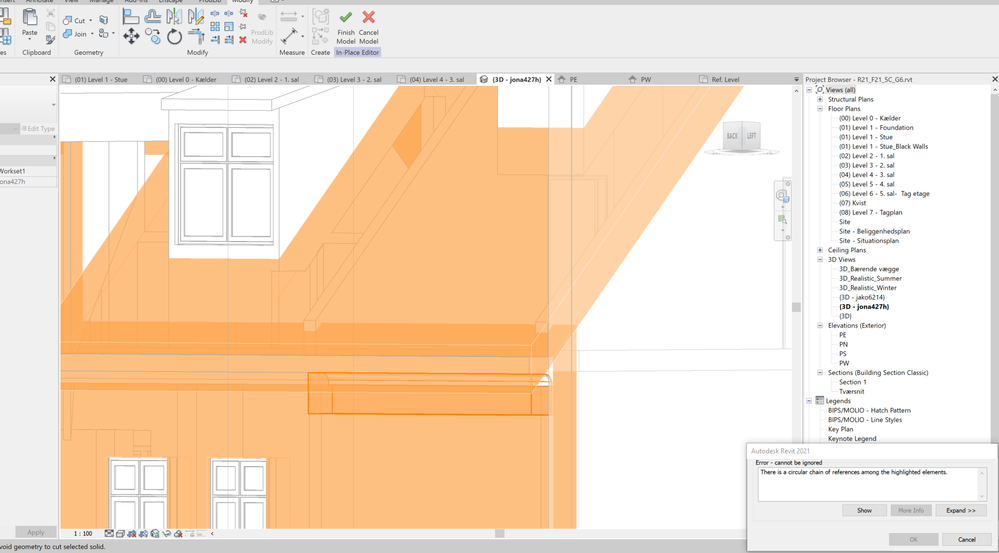

Get "There is a circular chain of references among the highlighted elements." When cutting out void in roof

Hi Guys
I'm trying to cut some of the roof by using a void form component, but when i try to cut out the void I get this message: There is a circular chain of references among the highlighted elements. It worked on the other side of the building with exactly the same method. See Screenshots:
Hope you can help Best regards!
The failing side:
The working side:

 Hard to know for sure from these screenshots, but it's not an uncommon error.   Post a short video.  Let's see what you are doing in real-time. Post your file too.
FWIW:
Error upon copying and pasting elements: "There is a circular chain of references..." | Revit Produc...

als Antwort auf: Anonymous
Try unjoining wall from the roof and see if you are able to resolved the circular chain.
