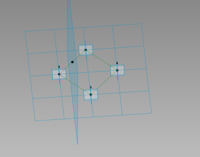

Hi Dears,
The attached image below is a Generic Model Pattern based family. The grid pattern is Rhomboid. i want to create a circle or square profile through out the green reference line, but before draw, when i try to set the work plan pressing with tab, i cannot pick the plane parallel with green line. its always align or parallel with the blue grid line. how i can pick like that.
The highlighted blue colored work plan i want parallel with 1 & 4 reference plane.
Thanks....

Select the point hosting on one of the green line and set it's work planes to be visible via properties. When you draw the profile, pick work plane and pick the plane shown at that point.

This is my problem , i cannot pick the the work plane of the specific point on green line. the work plane showing only parallel with blue colored grid line.

Use TAB on the point to cycle through the work planes.

The point does not look like it is hosted on the reference line. Points that are hosted on lines appear smaller. Points hosted to planes are larger. Select your point and click "pick new host" from the ribbon. Then host it to the ref line.
