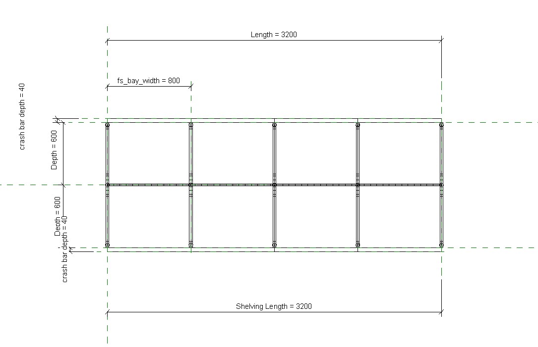

Hi Folks
Ive almost finished a Generic model line based array family.  Im using 'no of bays' as the array integer.
When I stretch the line in plan view, I can successfully create multiple arrays based on the length of the line.
The problem is when array = 1 the family can't create 1 array (bay)
Ive created a formula from what ive learnt but its not working.
The family contains components & geometry assigned to the array, 2+ parameter, and a separate component for when array = 1.
Anyone out there know a way to show 1 array when = 1?
1,858 Views
Ilic.Andrej
Since you created "array=1", "array=2+" visibility parameters and "bays array" integer with a formula "if(No of bays=1,2,No of bays), the family should be working.... I suggest you send us the family so that we can see what  causes the problem.
Andrej Ilić
phonetical: ændreɪ ilich
MSc Arch
Autodesk Expert Elite Alumni
Here a family I did for another member earlier this week, that shows how to build an Array family to work with only one instance.
Wrong iteration posted above. Right one attached here.
