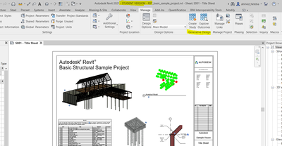

it's not related to licence type i have student version too but it exists
open autodesk desktop app and login it should appear and download

it should appear here
