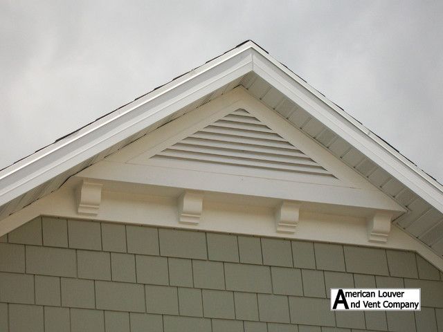

I'm trying to create a family for a gable end vent and I'm running into problems with getting a void to subtract from an array of rotated slats so I can achieve the tapered sides one sees with this kind of element.  Does anyone have any tips on how to do this? I've done a few families with voids in the past but something about the combination of an array and a void applied to the array appears to be problematic.  I've attached the file that represents my best effort so far.  Any help is greatly appreciated.

Few things. Do you need all that detail in your model?
My first approach would be to just use a material to fake the look or maybe to consider or some model lines. One of the first "rules" of Revit is not to model with too much detail. Especially arrays and voids are contributors to performance loss of your model
Alternatively, do you need to have it parametrized? Otherwise I would consider to make it just as a fixed model without any complicated arrays and voids

I guess the short answer here is that it is not vital to our cause but it would certainly help it. The use is a small custom residence where the client seems to appreciate every attempt at realism. Are you saying it isn't worth the trouble or that it is simply not possible? An alternative might be to use the curtain wall tool to create the sloped louvers. Still, the ability to impose a void on an array is something that has come up before and I'd like to know if it is possible.

You can cut an array with a void. There are only fewl limitations.
-You will have to start with the maximum amount of instances in the array.
When you increase the elements in the array, new objects are generated. The void will not cut those new objects
As in the screenshot Qty of array was increased from 5 to 6. You will see that last element is not cut.
So solution would be to start with maximum amount (of slats) and then decrease the elements in the array when needed (makes family potentially heavy)
Second thing is that void will only cut if the elements in the array are in the same family as the void. So a nested element cut by an a void in the host will not work. In your case you would have to create the slats and the void both in the host.
I would say I would not take the trouble as it will bring a lot of overhead to the project without adding much information (simple detail will be more helpful)
However if that is what you agreed with your client than you should try something
