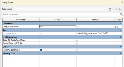

I'm having a problem with  inconsistant units in a generic annotation family. I have a yes/no parameter CheckBoxA and a text parameter TEXT. When I type the following formula into the TEXT parameter =if(CheckBoxA, "Yes", "No") I get the inconsistant units error. What am I missing?

blank...
Strange, works exactly as you described. Can you share the family?

Joris.vd.Meulen
I -think- you have the wrong parameter settings.
Ensure your parameter is set to "text".
