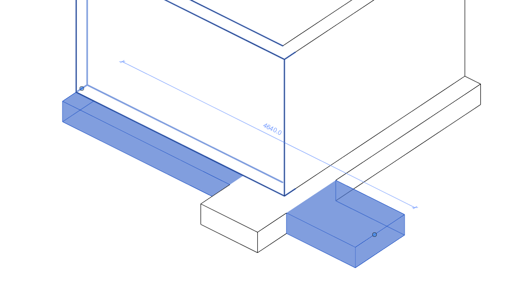

I have my wall footing set with an Eccentricity of 2 1/4". When I do this it doesn't allow my footing to clean out at the corners. Any ideas how to fix this?

Grip stretch the end of the footing out a bit then you can use Align tool to align them.

Thanks for the reply. I tried what you said but it will only clean up on side. My outside of footing line is set to be in line with the outside face of my wall.

Do the same steps for both sides.  See screencast in a few minutes.

I did the same step for both sides and only one side clears out.

Make a 5 1/2" wall and have your footing (24" wide by 12" deep) set to 3 1/4 Eccentricity (so the outside of the footing matches the outside of your wall) I still can not get the footings to clean up.

Disallow join to the walls and manually join geometry then you can align the footing to the face of the walls.
