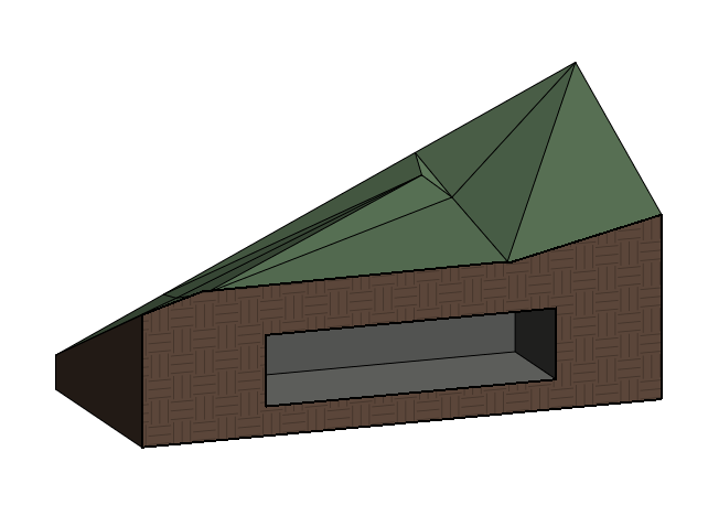

You are correct.  If a roff element has a slope applied then the shape editing tools are disabled.  I think I probably mis-spoke in that post 2 years ago, but hey the feature was only about a month old when i made that post, so can I get a little slack?
As for underground structures, it is a little bit of trouble because of the nature of the Revit totpsurface kind of being a hybrid of sorts.  It acts like a surface until it is cut in a view and then it gets "thickness" and looks a bit like it has volume.  Making the toposurface a real solid  and having additional elements (beyond just the pad) havign some relationship with it could help in creating underground spaces.
I did manage to ger somthing that looks a bit like an underground space bit using shape editing however.  In the example below I made a roof (but it could easily be a floor) and then shape edited it to create a "toposurface".  It is a bit faceted and ugly but might work.  Once I had my "site" I used an in place void family and used it to cut out a hollow space in my site.  Now you have a hollow space inside of a "site" and you could add floor, walls etc...
Maybe that will help you solve your situation?

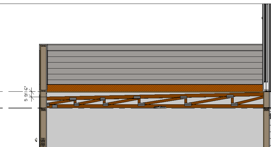

I stumbled upon this thread because I wanted to create a rooftop deck, where the roof slopes, and then above that are tapered sleepers so that the finish decking would be flat, and water would drain below on the slope to a gutter.
It seems that with variable thickness, the bottom will always be flat, and only the top will slope. I attempted to do this using modify shape tools (with the sleeper layer being a variable thickness (per your post), and then slope the whole floor so that the top would be level and the bottom slope.
Unfortunately, you can either slope or modify thickness, but cannot do both. Roof or Floor.
In my image, you can see the section of my (untapered) sleepers and deck structure, with the sloped truss below, but cant get the bottom of my deck to slope with the truss.
Message 13 of 17
You are correct.  When I need it, I have to model a main sloped floor or roof with a constant thickness, and another layer of floor or roof over it for the cricket, then join them.
