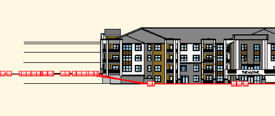

I have a floor that is partly on level 1, and then I have modified the sub elements of the other part to have a height equal to level 2.
On level 1, I see part of the floor that is within view range, and I have placed parking spaces on the floor as well and I see those that are within the view range as well. So level one behaves the way I want it to.
Level 2 shows me the whole floor, even the part that is out of view range, and it does not show the parking spaces that I placed on the floor that is at level 2.
I only want to see what is defined by the view range. when you modify a floors sub elements, that make it behave like stairs who disobey the view range?
They're not "disobeying" view range. See "Elements Below the Bottom Clip Plane and Within the View Depth".
Yes.  You would need to split it into different floors.  One on level 1, one on level 2.

I just split the floor. But I say disobey because it isn't below the bottom clip so it seems like it should be showing because it is within the view range.

I figured out the parking spaces visibility, view range issue (operator error). But the floor below the view depth is still visible. But no the floor that is at level is 10' below, but that portion is still visible.

Found this article that I think confirms if any part of the floor is within the view depth, the whole floor will show below. I wonder why its not the same for the top clip.
Because the view range actually cuts the floor at the cut plane, but there is no secondary cut plane at the bottom the view range/view depth, unlike the far clip offset for section/elevation/3d.
Yes. That's exactly what I was referencing.  The 4 foot behavior.  It is explained in that article I linked you to above.
