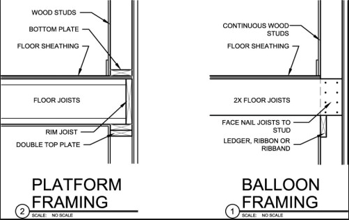

Maybe offset the bottom of the Cut Opening in the window family a tiny bit up.
Nachricht 19 von 39
als Antwort auf: Anonymous
@Anonymous wrote:
someone?
It seems to me that the issue you are having is brought about by that window you have placed at floor level. If you can't model it, then it stands to reason you can't build it.  The rough-in for the window obviously needs to be higher than the floor, whether or not it's Platform Framed or Balloon Framed. So raise the window. That's the solution.  Simple.  The wall and floor are joining correctly for platform framed construction.
FWIW...
