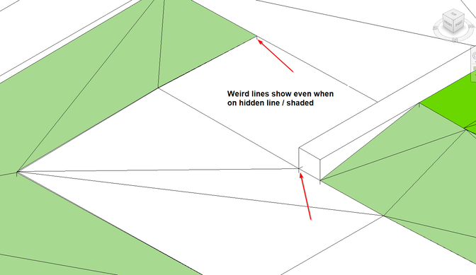

Does anybody know what causes this? Floor Sub elements not showing at the correct location and portion of elements showing wireframe even when set to hidden line or shaded? I've tried hardware acceleration on and off.

Hard to decipher your screenshots. One question come to mind though; is there a "Variable" layer?

I'll try for a better screenshot however the displacement of the drag points gets worse as you zoom in.
Happens on all floors (with and without variable layers). This floor here has no variable layers.
Revit 2020.2 3D view. Things I've tried:
View Scale
View Detail Level
Recreating views
Turning off all links
Hardware acceleration off
My thinking is it's computer related but it was fine up till now. Just wanted to see if anyone had come across the problem before.

I still don't get it what the issue is.

Sorted it. Seems there was a linked RVT file with large extents and even with all links turned off in the view it didn't fix it. I had to unload the link from the project and then delete/recreate the 3D view and now it is behaving normally. If I reload the link it goes bad again, I'll just have to get the linked file fixed up.
