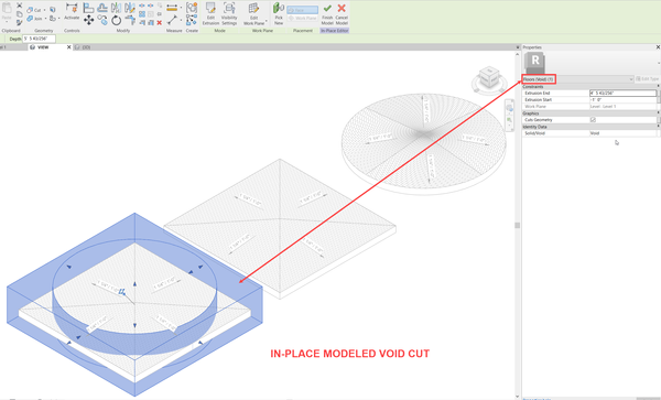

I'm looking for a solution how to make it look correct - as we have modified sub elements of the floor, its pattern gets messed up.
Temporary solution was to create a Fill Region with Model Pattern but in the end, it's impossible to send Detail Items below model components. The pattern overlaps doors and fence which is clearly visible in PDF.
How would you approach it?

Hi, unfortunately - as mentioned, the Fill Region goes over doors and fencing, and makes it look dashed :enttäuschtes_Gesicht:

Got a better solution for you I think.  Instead of shaping your Floor with the Sketch Boundary, make the Floor Sketch Boundary square or rectangular, and shape it using a In-Place Modeled Void Cut after you Modify Sub-Elements.
