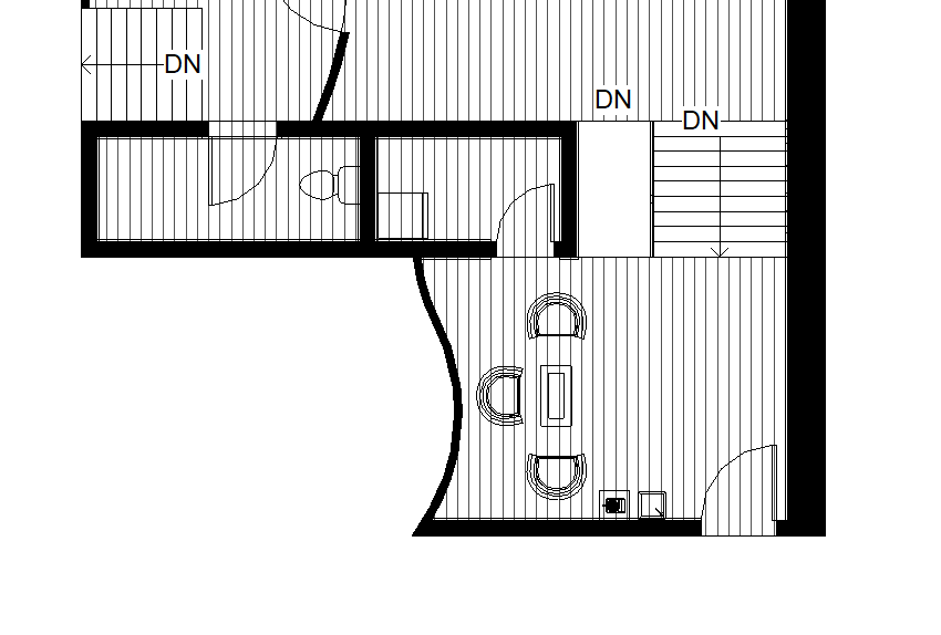

I have been able to apply the fill to my floors in a ground floor perspective.
However, the pattern runs through my furniture as well.
How can I change that the pattern doesn't run through my furniture?
Nachricht 5 von 6
als Antwort auf: 20445393
Edit the Families that are "transparent" in Project Plan View (e.g. show floor line work through them). In the Family, go to Plan View and add a Masking Region to it. Reload into Project.
