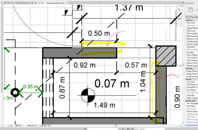

Floor Lines Printing over Wall Lines
I am having an issue when printing...
The issue is that when i print, if the floor line (grey) is in line with the wall lines, the floor lines are getting printed over the wall lines.
The image on the left shows the view from Revit, the image on the right is what gets printed, you can see that the floor line is printed over the wall line.
Is there a reason why this happens or a trick so it doesn't? Any help appreciated.

cbcarch
als Antwort auf: Anonymous
Try to change the printer driver setttings to Vector or Raster, and see if there are any differences.

Nachricht 3 von 3
sebas_alva_g
Thank you, didn´t work in my case... nor raster nor vector
