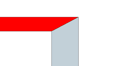

 Hi! I am wondering if this is a possible in revit? In actual construction, this is typically seen in counters and ledges.

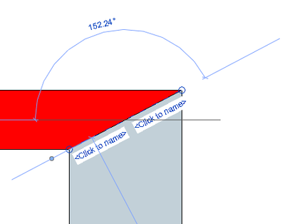

Yes, you will need to use a reference plane for the wall and a void for cutting the floor
Create the RP in a section view and attach the top of the wall at it:
Then create  an extrusion void and use it to cut the floor:
