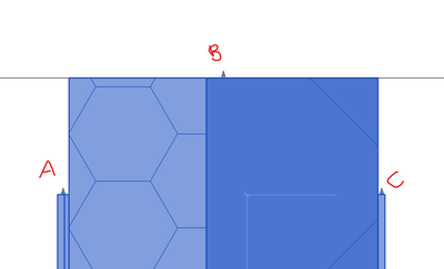

@RDAOU  Is there a way to make both neighbouring layers unlocked and than have separate shape handles for eache of them?
I would need to add 2 cm top offset for the structural layer (layer 2), layer 1 has to come down (red angle in screensot) and layers from 3-6 have to be from bottom to top.

RDAOU
@dm0144
If you are using parts you can...
Using Unlocked/Locked wall layers no...
  1. If the left and right slabs would have had the same bottom height, you would  unlock the middle adjacent layers and keep the outer ones locked then instead of stretching the plaster layer down, you would stretch the core up
  2. However, in any case (same bottom height or different bottom height slabs) you shouldn't need to unlock more than one side/layer...the other side you can achieve with join geometry
Below I unlocked only the 20mm outer plaster (red) ...the inner part (green) I used Join Geometry.

I think the work around the detail that I am after can be achived with having both neighbouring layers, Structure 1 and Finish 5, unlocked in section.
If there is the limitation where unlocked layers must be adjasent and not seperated by locked layer (correct me here if I am wrong), than why I only get one shape handle for both layers instead of one for each unlocked layer?
Have a look at the screenshot attached.
Desired heights of each layer or set of layers is colored accordingly from 1 to 3.
The desired height of layers 3 is at the floor level, though it is not visible in the section since the connection at the section is correct.

RDAOU
ok...if you feel that would give the results you are after, then sure why not. However, unlocking 2 adjacent layers get 1 shape handle..refer to previous reply
max shape handles you can get is 2... You will get 3 shape handles when u unlock the adjacent Middle layers and keep the outer ones locked...However, in reality they (Handle a and C) are the same
