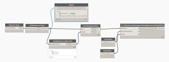

When I mirror objects in Revit, nothing breaks.
However, when I export the model to FBX, in 3dsMax for example, I notice that the meshes are scaled in a negative axis.
Result in 3dsMaxResult in 3dsMax
How can I find these objects?
Please see the attaced revit-file (ver 2017) for reference.

Dynamo can help.  A simple script

L.Maas
als Antwort auf: Haider_of_Sweden
No tags or something. Possibly Model Review  could do something, see HERE.
You could modify the script slightly and do the following
Instead of coloring red (you could do both) the text "Mirrored" is written in the comments parameter of the elements
Then it is a matter of building a filter and use it in a view to hide lements that do not have the word wmirrored in the comments. Or you could elaborate on the script and manipulate the objects (e.g delete, mirror).
Louis

Here comes a very late Thank you @L.Maas :grinsendes_Gesicht_mit_lächelnden_Augen:
There are some follow-up questions:
  • Why is it hard to search? I searched for All Elements of Type, but instead I had to google it so that I knew this was under Revit > Selection
  • How do you create this output-list underneath FamilyInstance.IsMirrored?
  • What node should I use if I want Dynamo to actually select the items for me, instead of only red-coloring them or adding a comment to them?
Nachricht 8 von 8
L.Maas
You can hover over the node and a white panel will open with a pin. Clicking on the pin will leave it open. Or you attach a watch node
There is not a standard node that creates a selection in Revit and then leaves it up to the user to take following action. In those cases you would normally use/create filters or manual selection sets. With Dynamo you would decide on the following actions and let Dynamo do them for you (e.g. add values to parameters, delete them).
However there is a custom package Modelical that seems to have such a node. See THIS YouTube video for explanation.
