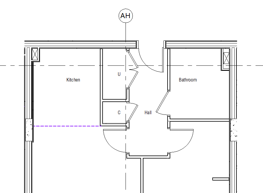

Hi All,
Really frustrating issue here.
I've got filters set up to hatch different Rooms with different patterns to show different floor types (already created as Area Plans so can't use colour fill legends).
These filters work perfectly on screen, but when printing to PDF or even checking 'Print Preview' they don't display.
Is there something obvious I'm missing, or is this simply another bug we have to deal with?

It doesn't even show the hatches on print preview - so it's not the PDF writer.

Below is a screenshot of a part of a plan on screen, and below how it displays on print preview:

als Antwort auf: jay_clancy
I see why. While you can use Filters to show hatch pattern for rooms. They will not print because Room interior fills don't print, only Room color fill do.
