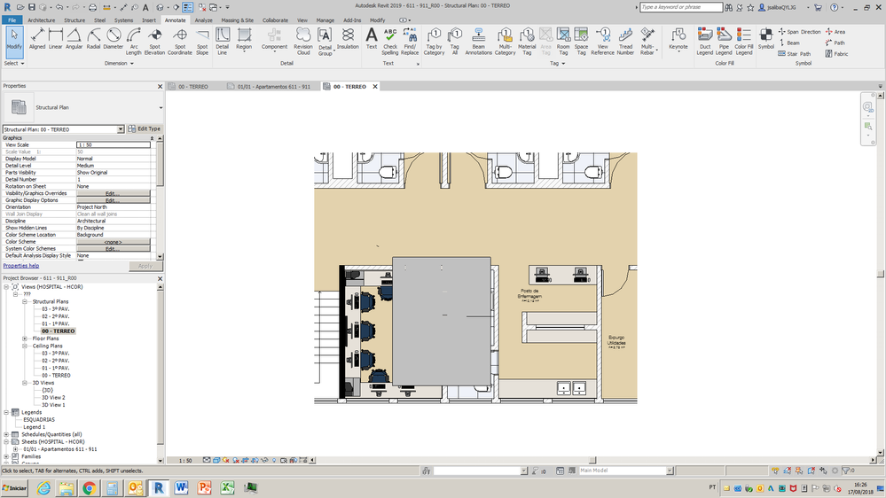

I have been using Revit 2019 on my new desktop, and it seems that my Filled Region is covering my model.
I have already unchecked the Masking option.
While checking to see how I had edited my Filled Region on my notebook, I realized that the problem is in the Revit installed in my Desktop because the same file works perfectly in the other computer.
As shown on the images below, "image_01" is of the file on the Desktop. The "image_02" is of the same file with the same setup opened in the notebook that, btw also is running Revit 2019.
image_01image_01
image_02image_02Thank you very much,
Jorge

As I mentioned... It is in Revit 2019! There is no more "Transparency/Opaque" option on the Filled Region.Masking OptionMasking Option
Nachricht 8 von 15
jsalibaQYLJG
als Antwort auf: barthbradley
Here's the file, as requested, but as I mentioned... The file works fine on other computers. Just on this current desktop that it appears to have this bug... This is how I see the file when I open it over here.This is how I see the file when I open it over here.

Yes, I am aware that I can make it transparent like that, but I wanted to actually fix this bug.
When I printed it, it came out like the “image_02” in the post, so I figure it may have something to do with the graphics card, or something of the kind, that is affecting only how I view my project.
As I said, the problem is in my Revit Settings, and not in the File Settigns.
Does anyone have any suggestions?

Turn off hardware acceleration and if it works then you video card is the culprit.
Nachricht 13 von 15
jsalibaQYLJG
als Antwort auf: ToanDN
Yeah @ToanDN, it worked.
Does that mean that my Video Card isn't good enough to support Revit?
Thanks a lot!
Nachricht 14 von 15
als Antwort auf: jsalibaQYLJG
Thanks a lot!
It can be one possibility.  It can also caused by a combination of OS, video card and its driver.  What is you Windows version (7) and what is the videocard?

I belive my video card is ATI Radeon HD 3450 and I am running Windows 7.
Processor is Intel Core i3-3220 - 3.3GHz (In case it makes a difference...)
