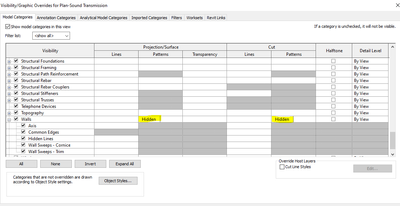

I'm trying to assign a 1 HR filled region pattern to the rated walls, but the filled region is not aligning with the wall properly. It works in other Revit models but in the template I'm working now is not working. I have already a lot of things in there that I don't want to create a new template file and transfer everything. Please Help

It works if you apply the pattern to the wall type's Coarse Scale Fill Pattern.  If you override the wall cut pattern using any other method such as a view filter or override element/category in view, then the pattern will not align to the wall orientation.

In your VV overrides, is there any way there is an override on the detail level of the wall category?
When I test this using a filter to apply the custom hatch, the detail level of the view affects how it is displayeddetail level.png. At coarse, it displays as aligning with the wall orientation, but in medium or fine it reverts to displaying oriented to the view.

I have tested the project file and the template... either way, what I think is happening is the filter is enabled but your override of the cut pattern in the wall area is causing the filter to switch it's behaviour.
but when the pattern override is turned off the pattern switches to the orientation you want:
so, to have the orientation you want, you cannot have any overrides on the pattern for walls or it seems to change the pattern display. i think this is just Revit behaviour that can't be changed :enttäuschtes_Gesicht:
I think @ToanDN mentioned this behaviour above. ANY override on the wall will mess with the orientation of the pattern override.

Now its working :Gesicht,_das_eine_Umarmung_gibt:.
Thank you @emodderman and @ToanDN, I was not aware that overwrites could cause this type of behaviors.

I'm having the same problem with my walls. It works in one model, but not the other.  Walls, patterns, and filters are identical.
Notice the pattern in the green walls doesn't rotate to match the wall element. in the second model, but it works in the first model.

Problem solved.  Found this in the template where the pattern did not work:
Removed the overrides and it works just fine.
