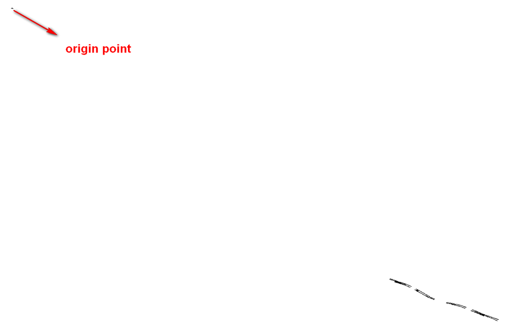

I have one revit file that have multiple Directshapes. The files size is abou 102MB.
I seperates these items according to the scheme as below, the items in one red box will be save as one file, so I have 4 new files.
I don't understand is  all the 4 new files have the same size as the originl file (102MB)
File link is here: https://drive.google.com/drive/folders/14Zx5ETTMF9zvMIXkmZQ1Zw4cDsdSFiT0?usp=sharing
In 3D view, please zoom to extents to find the objects.

I can't open your file.  Too large to scan for viruses.  But why  "zoom to extents to find the objects" ?   Revit has a distance from Internal Origin limit (10 miles).  If elements are beyond that limit, issues happen.
FWIW.

Basiclly, the model I uploaded is bridge barrier of a highway bridge project.
I have no problem the other bridge components, like girder, cap beam, pile cap, etc.
The file size of the above components seems correct to me.
For virus scaning issue, looks like goole has limited ability.
