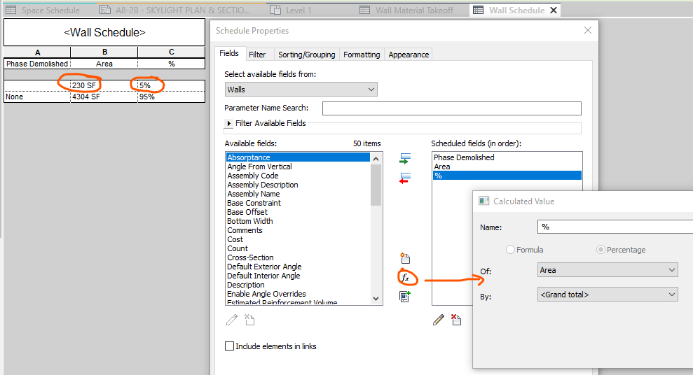

A different approach that does not require any manual input:
- create walls in phase 1
- create doors and windows in phase 2
- create a wall schedule in phase 2, phase filter = show all
- add phase demolished and area parameters to schedule, format area to calculate totals
- sort by phase demolished, untick itemized
- create a calculated parameter, choose percentage, not formula
Now you have fenestration %.

Similar to @ToanDN method. Create a new phase called Wall Penetration. Have doors and windows demolished at this phase. However if you want to split the schedule into each individual column area like you see below
 Simply add YES/NO parameter to separate the fenestration. Then use the calculated value to extract the area.

See attached file and see how the schedule works

@ToanDN & @syman2000 I was able to get it to work. Thank you for your assistance. As always, greatly appreciated! mpp
