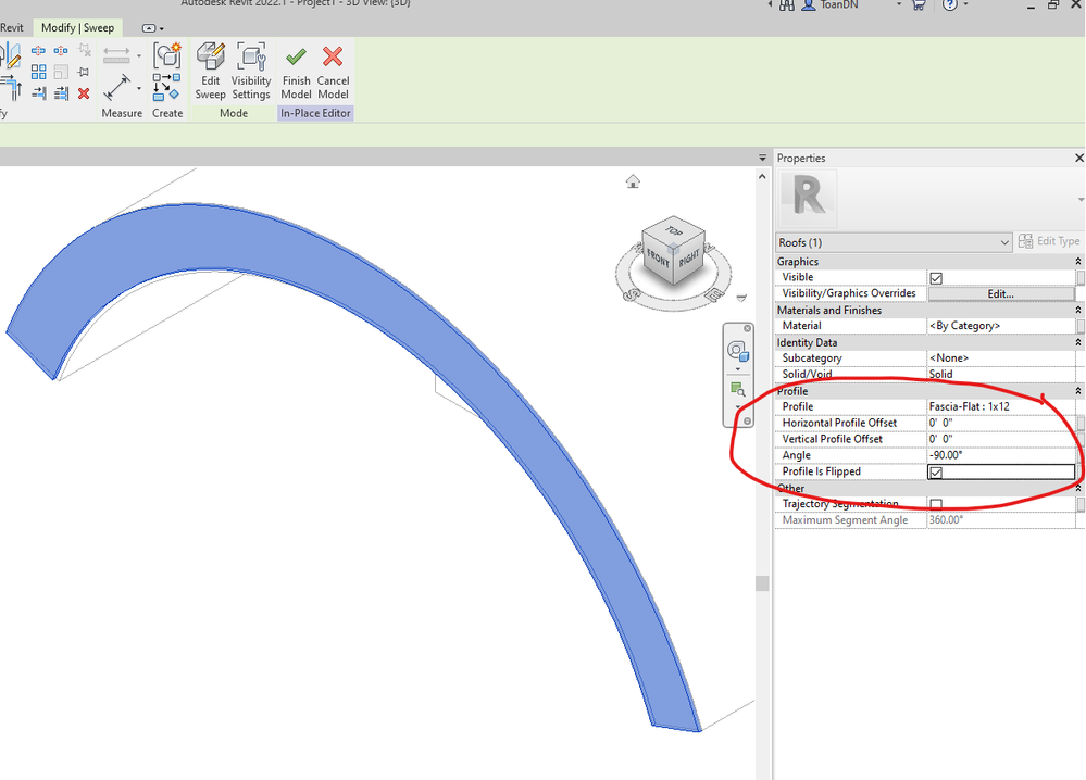

The curved roof below was created by using "roof by extrusion".  I am getting an error when attempting to attached a fascia board to the face of the roof as seen in the image below:
Is the fascia tool supposed to work on this type of roof?

Create an in place sweep using the same fascia profile instead?

No issues here.
Maybe try a Profile Offset?

Is the fascia your own custom profile or OOTB profile? If it is custom, check and make sure the lines are closed without overlapping lines or extended lines.

It is an odd behavior. If I shorten the roof, it works.
As well I add flat extension, it will create the arc fascia.

You could just make the Fascia with the Roof by Extrusion method as well.  :zwinkerndes_Gesicht:
....zero out the Fascia Depth and make the Rafter Cut a Plumb Cut. The Roof Fascia works on the Roof by Extrusion then.
