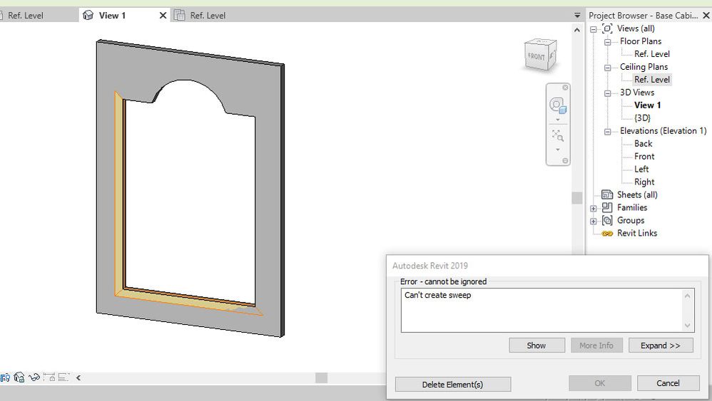

Hi
This is my first Family exercise. I'm trying to create a decorative kitchen cabinet panel. For some reason I can't succeed to create a Void Sweep for it. Below a list of things I tried:
  1. Panel Extrusion from both Top and Front View.
  2. I tried Void Extrusion and a Shape inside the panel extrusion to make the void panel.
  3. Different shapes of Path.
  4. Different shapes of Profile.
Thank you

no problem here.  I broke it down into 2 separate void sweeps: 1 for the straight edges and 1 for the arched edge.
...here's another approach for you: Cut to Clipboard and Paste Align to same place. Do a solid sweep (not void sweep). Convert Solid Sweet  to Void Sweep. Cut Geometry.   Align and lock the Geometry as you had it before, because the Cut/Paste action removed all the constraints.

Below approach didn't work. I also removed related Reference Planes, and did both Solid Sweep and Void sweep. I always have the same common error.

Are you doing it as 2 sweeps? It can't be done as 1 continuous sweep.

Use Pick Path instead of Sketch Path, and pick the Arc first.  File attached, one void sweep.

Yep, I can do it as one continuous void sweep today too.  Couldn't yesterday.  I wouldn't have used Sketch Path, so I don't know why it failed yesterday.   Easy breezy though.
...AH!!! It an order of operation thing!  Pick the vertical straight edge first and the arch last, and the Sweep Fails.  Pick the arch first and the Sweep works.  Why; I dunno.

Try selecting the path in a different order. Start with the arch.

Only starting with the Arch works. I also copied the path outside the panel and the sweep worked staring by selecting any line. My problem is solved but I don't understand what happened.
