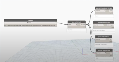

I'm seeking advice regarding upgrading Revit families from an older version (such as 2016) to a more recent version (for example, 2024). I'm aware that the upgrade process may lead to potential Family corruption, or data loss due to compatibility issues. Therefore, my question is: "Is it possible to obtain a comprehensive report detailing the changes or losses that may occur during such an upgrade?"

I am assuming you are looking for an out-of-the-box solution, and I have not seen this, but you can do a couple of workarounds to get your purpose with a box solution.
You can always look at the log journal which should have a full description of the process

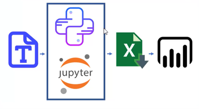

5. Check your journal file for more data you can use dynamo to gather this information
You can visualize the journal with a creative workflow, since it is a text file then use Python + Jupyter to parse and convert the information (data) to Excel file and then you can visualize  in a PowerBi
