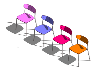

Here's my quickie solution. See attached.
NOTE: Frame is Shared and Nested into Seat and Back Family. Family 1=Seat/Back w/ Nested Frame. Family 2=Frame.

@tmccar wrote:
Thanks for that
Did you set colours in Autocad?
No. I changed the colors via Override Graphics in View By Element.  I showed a screenshot above.  You could also change colors via Filters.
