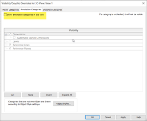

Why don't you just uncheck the Annotation Category for the Thumbnail View?

I do. It's work I would like Revit to eliminate so it just saves a clean thumbnail without extra thought--especially when users go in to create families. I realize I meant to post this in the ideas forum, not discussion forum. I'll be reposting there when the 1-hour re-post blocker is lifted.

How would Revit know what you want your thumbnails to look like if you don't tell it?
If you really want to make it a more efficient process, go into all of your family templates and add a new 3D view dedicated to the thumbnail. Set all of the V/G settings to whatever you want. Then all you'd have to do for new families is orient the 3D view how you want.

Hello @Ryan_Williams-MRB ,
There are addons like PIG that helps creating proper thumbnails, basically, you can have a template per Revit category and each time you save, it follows the template you defined. If you make or manage plenty of families, it's pretty handy to be honest.
