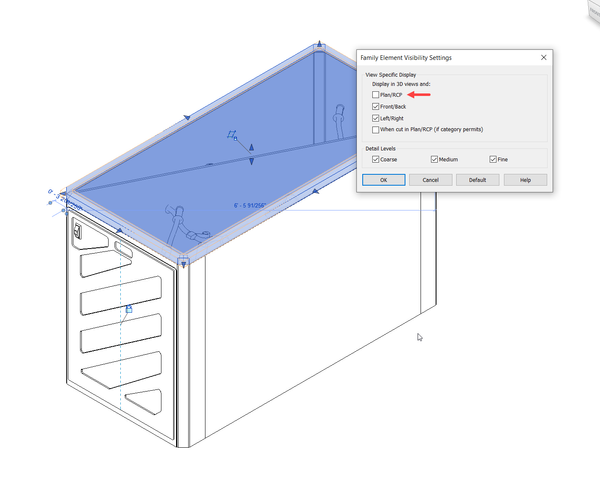

Hello all,
Two different families I am hosting on a certain level are having visibility issues in plan view. In this 3D view, you can see (1) bike storage lockers x4 and (2) trash bins x2:
In plan view, the bike lockers appear as a dashed line, and the trash cans don't appear at all.
Here are my view range settings:
So I can understand why the bike lockers appear dashed, but I would assume that the cans would also display some kind of cut line. I would like to make an adjustment to the bike locker view lines as well because in my site plan, they still appear dashed, while I would expect them to appear as solid outlines.
Linking the families for reference.
edit - bike lockers are okay in site view now.
Revit is amazing

Symbolic lines are 2D elements. They do not show in 3D Views.
Nachricht 3 von 5
als Antwort auf: cbt990
Turn ON Furniture category.
Nachricht 4 von 5
Change your View Detail Level to Medium or Fine.
...or go through and change the Visibility Settings of the Geometry in the Family.

That was an easy one, thanks all.
