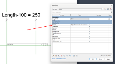

Is it possible to assign "Family-wide" parameters instead of Family Type parameters? For example I want to assign URL from manufacturer website for a wall tie. This URL points to all "family types" (different lengths of wall ties) manufacturer provides.
My intuition would be that this information belongs to the family itself and not individual types.
Right now I have to assign the same parameter value for each type, which is tedious and seems "semantically incorrect".
Alternatively, do you know a quick way to assign a value to all family type paramaters :leicht_lächelndes_Gesicht: ?
Please let me know if I missed something.

Revit lacks a built-in method to assign parameters directly to the family without repeating them for each type. You can use a Shared Parameter for the URL or other "family-wide" data. While it still applies to each type, it’s easier to manage globally across families, reducing long-term redundancy.

I think what would be even better if you could enter the URL in the Formula field. And maybe even use "if" and other functions.
Best idea i have is to enter the URL with the first type I create and each new type will then start out with the same URL. Obviously this isn't great if I change manufacturers later.
Just as a side note, I only use the highest level company URL and let the contractor find out how to get to the URL of that specific product. the reason is, those sub level URL change around a lot  when manufacturer re-designs their website. Maybe this is worse initially, but ensures easy maintenance and ensures I legally gave the correct URL and not a 404.

Thanks everyone, that's good to know. I prompted chatgpt to write a command to let user write a value of a selected parameter to selected family types to speed up copying it across family types.
It took a bit longer to write than I expected (had to switch to "o1-preview model" after "4o model" run into problems), so I don't think that this one will return its "cost of investment" considering that I could have just manually entered these values. But let's see, it's fun though and I'm glad I didn't miss anything obvious in revit.

Type the information in the formula boxes.

URL (the actual URL data type) don't accept formulas.... But I just had an idea. Why not create a text parameter and make that look like an URL? That way you can use formulas and can prescribe it for all types in a family at once.
The URL has a functionality and a functioning link. but I never use that linking capability. Using dumb text for URL might be better?

Can't you do this through a NON itemized Schedule? Enter one URL for all?

How about a Type Catalog?
Specially if it has a fixed number of values from the supplier + the values are easier to replace in a txt document.
And import all types to overwrite the ones in the project.

Thanks, I didn't know about Family Type Catalog. I'd agree that if there were more complex changes than copying the same value across all parameters this would come super useful. It's format appears to be csv-like, so maybe you could even give it someone to edit in excel?
However, for this particular question where parameter is the same and you just want to assign it "family-wide" I'd rather do it without having to reopen the family editor.

Well then, how about bringing all the Families into a Project Environment, adding the URL via Schedule and then "batch" saving all of the Families out of Project via Save As Library.
https://help.autodesk.com/view/RVT/2025/ENU/?guid=GUID-FC6CC53B-0010-4AF9-BFE2-6B044191A645
Seems the least PITA way to go about it.

the script I mentioned above (marked as answer now) works fine and runs directly in the family editor
