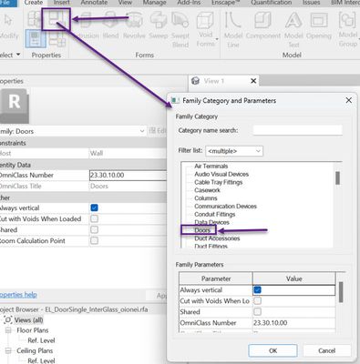

Can you share the family?
Probably, as @ToanDN says, the family category is not correct.
Open the family and check if the category "Doors" is selected.
If not, select it and reload the family to project.
