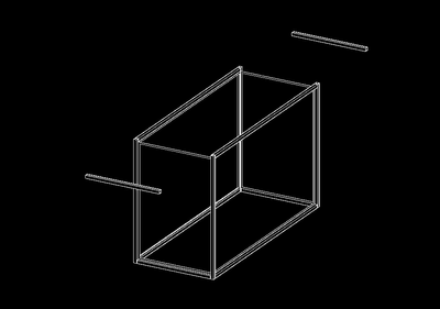

Hi
I am having issues with a paramatic frame that I am making a family of. I want it to be adjustable in height, width and length. It mostly works however when I change from different types that I have set (i.e. different dimensions) it doesnt always seem to lock the dimensions and throws the constraint error.
I am not sure if this has to do with the way structural framing members and columns snap ? I might try doing it via a sweep but would prefer to do it this way.
Anyone able to suggest what i am missing? I have it all snapped to reference planes but just doesnt seem to want to stay. I think the error occurs when it goes from pod 5 to pod 4

i think i might have sorted it - think it was to do with disallowing beam joins at ends and providing more reference planes. now currently looks like this with reference planes each side evenly spaced
was previously like this which i think was the wrong way to do it

Why are you using Structural Framing Families in this Family? Serious as a heart attack question.
Have you considered building this "Family" as an RVT that can be Loaded As Group into other RVTs?

Sure. When changing between the different family types it will break the constraints I have made (to the references) and break the frame. I have currently got it as a generic model family with structural framing member + structural column inserted. - what would be the new suggestion be for line based ? what family template do i use ?
