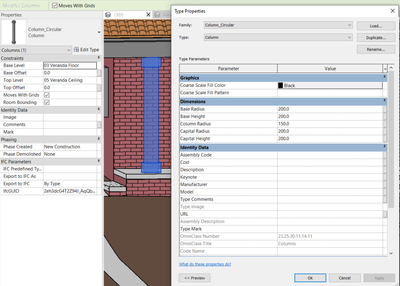

I built the column family, basded on metric column family template. In its basic form, the column looks like this:
Creating an instance in Revit, gives the right outcome, and I can control its level constraints on the Property pallet, and also its dimensions in the Edit Type winow :
As I do have a job requirement to fulfill - so it's not related to my liking really, I need the Edit Type window to show a read-only parameter that displays the total height of the column, from the bottom of the column base to the top of the column capital. Please explain how to get that as in over 3 hours I practically tried everything and nothing worked.

When I said I spent over 3 hours trying, I actually meant I was trying almost ALL possible combinatons when creating a Shared, Reporting Instance, and nothing worked!
Here is how I set it up:
Clicking ok on all, and placing the new Height parameter to a dimension, it does show correctly in the family editor:
However, I still can't see the Height in the Edit Type window in the Revit model - which what I really, REALLY need, but rather on the properties pallet only:
How can I make it show in the Dimensions area, where I'm placing a question mark? PLEASE HELP!
