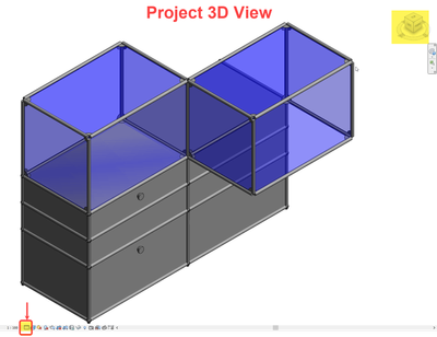

Hi, I am experiencing the same issue as the other user, but it's about wireframe display, it's displayed correct, but not showing up the entire model. Could you please take a look for me?
It shows up as the second image.

Nothing is visible!  You need to edit each Nested Family and change the Visibility Settings of all the elements in it. Check all the boxes under Visibility Settings and reload the Nested Families into the Parent Family.
Then, in the Parent Family, make the Nested Family elements visible by checking all the boxes under each Nested Families Instance Properties.

Hi, I did both steps for all parts but it's still not displayed correctly. How do I reload nested parts into family? Maybe I didn't do that part correctly.

What's wrong with it?  Your screenshot looks identical to mine above.  That's how everything looks. That's how you've assembled it in the Parent Family.

yes it looks the same as yours, but in 3D view is still look like this, not sure why

This is how your USM Haller room divider 1536x536740-1240 mm.rfa looks in 3D View on my end -- after I make all the geometries visible, as per my instruction above.

yes, when it's in the model edit view, it looks correct just like your screenshot, but when I import to my project, it appears incorrectly. In project plan view or elevation view, everything shows up. Only 3D view is not working.

Change the view to Fine.

It worked! Thank you so much!!

If you changed the Visibility Settings like I told you above (and you confirmed you did), then it should be visible at all Detail Levels.

I think I know what's going on now.  When you load it back into Project, OVERWRITE ALL PARAMETER VALUES when prompted.
