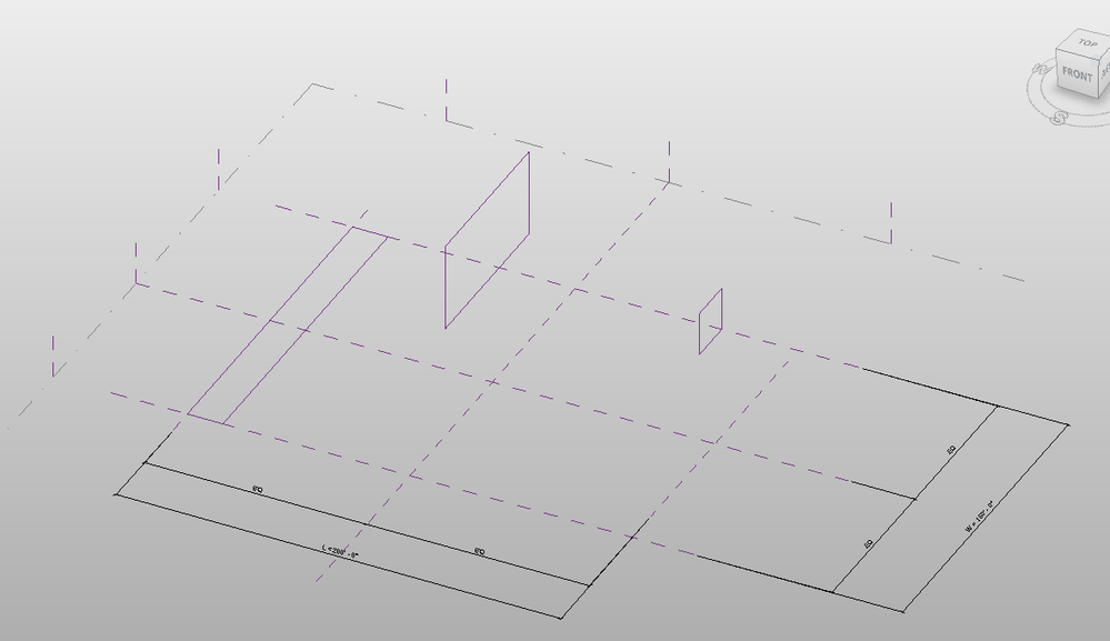

Hi guys... Trying to give a simple dimensions (Height, Width, Length) to this shape I created.
Just created snapped plains surrounding it, did an aligned dimension for each parameter and created the parameter, But in the projects changin them doesn't do anything.
Need help with this please, My understanding with this kinds of stuff is very limited.
Screen Shot 2018-01-20 at 23.52.28.pngScreen Shot 2018-01-20 at 23.52.16.png

Draw the profiles as reference lines on reference planes or constrain their edges to reference planes before you create a form.

Thanks for your response but can you please be a bit more specific? Do you mean that I need to cut the object so the edges lines will fit with the plain? Attached below the rfa
