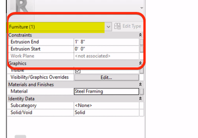

My cut material is not showing for this one material when applied to a family object (the object is 'furniture' category). mstsc_ADf6N2Psia.png
I noticed that if I change the discipline from Architectural to Mechanical, I can control the pattern with the "Background" option (It's not clear what that is for and is not covered in documentation it seems). That doesn't help much though.

The family u are using is a Furniture Family you need to use a Cuttable family (Example: Generic Model)
For you second question: Discipline and the Material's Background Pattern are not related.. (when you switch discipline to Mechanical, non-mechanical families will be overridden and treated as underlay

I had a feeling that was the case. Will it work with a nested generic model?

Here is a nested generic model with the same material applied. Still shows as solid gray instead of the diagonal lines. mstsc_ZqECejnhJG.png

If you nest a generic model into a Furniture, it will behave like a furniture...Unless you make the nested generic model family Shared then it will be cuttable in the project

Amazing. Thanks @RDAOU you the MVP
