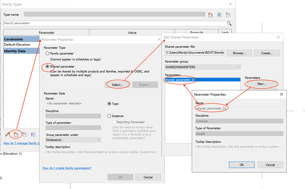

@hmunsell wrote:
if you want the parameter to effect multiple instances, like @Anonymous said, they need to be type parameters. you would then need to make Families Types in the parent family, one for each unique condition.
are you creating custom parameters in your families? for them to show in the schedule they need to be Shared Parameters. Shared/Project  are a whole other can or worms if you are new to families. they need to be well managed.
That.

By parent family, you have a family called Soap Dispenser, in that family you need to have one that is 4"x6" and another that needs to be 9"x4". those would be 2 Types in the Soap Dispenser family. in the type properties, select New type, change the dimensions and pick New type again and change dimensions, rinse and repeat as many times as needed.
if your using shared parameters, in order to do anything with them you also need to make a project parameter in the model with the same name.

Yep, forgot to mention that one... good point.
