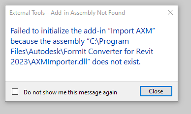

every time i open revit 2023 i get this error:
failed to initialize the add-in "import axm" because the assembly "c:program files\autodesk\formit converter for revit 2023\axm importer.dll" does not exist
followed by this error:
failed to initialize the add-in "formit conversion" because the assembly "c:\program files\autodesk\formit converter for revit 2023\formitconverterribbon.dll" does not exist.
attached are the screenshots.
following this. When i try to run to update revit 2023.1.2 it failed and this is the error i get: also attached.
its obviously connected. and even after i uninstalled revit 2023 and reinstalled it still get error 1 and error 2 see images. and i cannot update to 2023.1.2

It happens to me also, when i tried to link axm file inside Revit 2023. But when i tried to link it using Revit 2022 it was fine. So i guess somewhere along the upgrade thing, the connectivity was unintentionally omitted, i don't know.

Our solution was to uninstall the formit converter... but it would nice if it stopped being packaged with the product.
