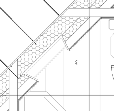

I have modeled a triangular window to be used on attic kind of roof.
I have modeled as a generic model face-based but when I change its category to Window, it does not being cut correctly in the floorplan.
No matter what settings I choose in the Window family visibility, nothing changes, it displays it like a top view.
How can I have it shown in a Window schedule and  have it cut correctly in the floorplan view?
This is as a Window category
This is as a generic face-based

If you want to have a Windows Category as a family, you could do a workaround:
- In the family editor, make all the Solids (elements) - to NOT be visible in e.g. FIne, Medium Detail Level and not be "Plan/RCP"
- Then you would need to create" Symbolic Lines" in the same Areas (or cut planes) that you want it to be seen in your Floor plan in project. These Symbolic Lines have their own Subcategory, which you can control under Windows Category in you Project.
It take some work in the Family of the window - you have to properly align and Lock all the symbolic lines, but once it works, you should be able to see the window properly cut.

Ok, I tried something without Smbyolic Lines and the Window lines are shown in Floor Plan (when cut) and also in section.
- Choose Extrusion of the Frame and set it as "Frame/Mullion" subcategory and make it seen in all Detail levels.
-Make sure in your rpoject that "Frame/Mullion subcategory is checked then reload your family to the project
This is you family of window inserted in my tested project (sloped Roof/Floor).

In the family almost everything is the same..
When cutting the window in your project, you can modify how a certain Subcategory is presented. See example bellow for Frame/Mullion.
Then, when you insert your family with modified Visibility settings, you see a cut like this (at least in my case):
