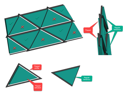

how do I stop this extrusion from flipping when the adaptive points move around?

Apologies, it is woring now, by using points and lines along the edges instead of along the diagonals  :

Hi, thank you Jonathan,
but now the same is happening with a triangular panels, and I cannot find a way to make it work...
See screen shots...

Any idea?
